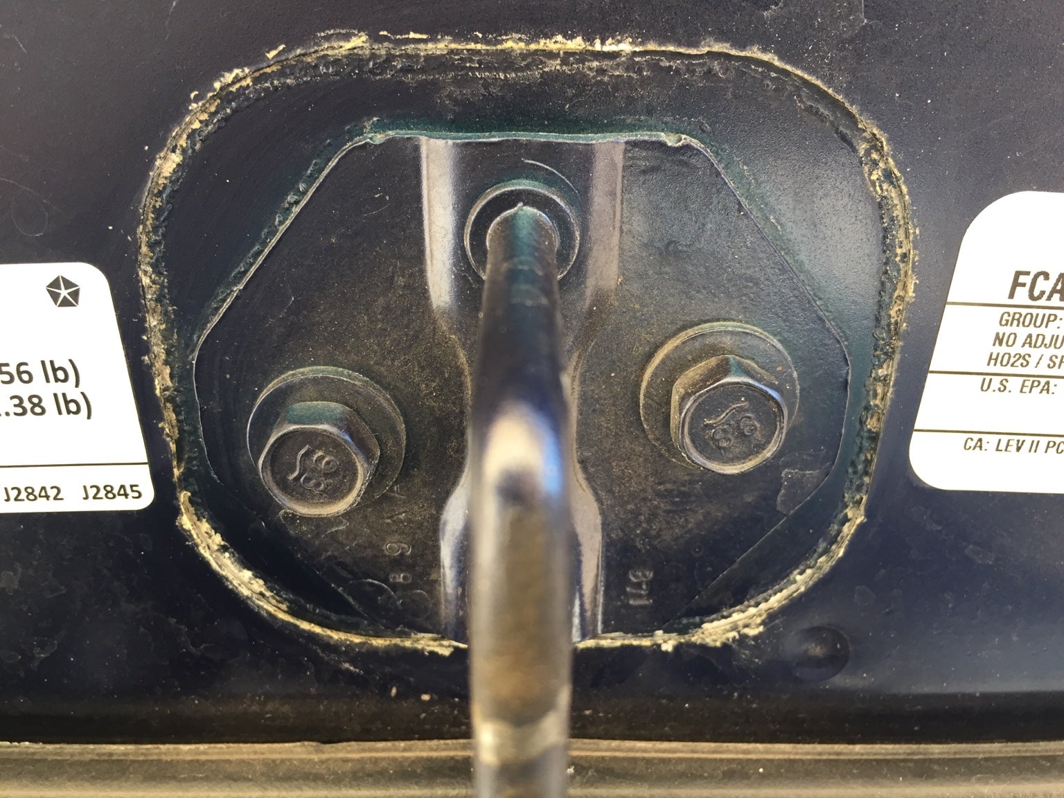

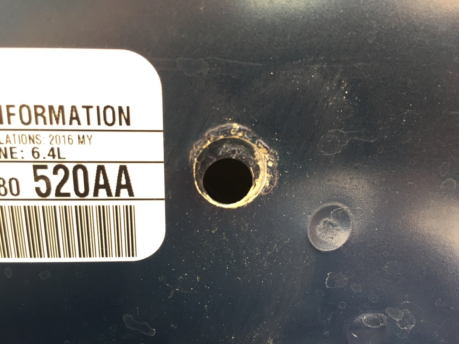

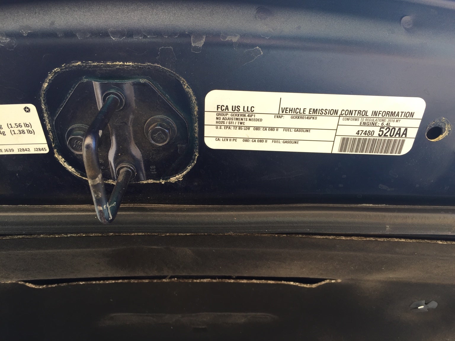

Looking for some input. I noticed this after changing my oil yesterday. I know our hoods are aluminum, and it would make sense if steel was used in certain areas for rigidity and strength reinforcement. Problem is, to my knowledge, is that the two dissimilar metals can corrode if in constant contact with each other. I was looking at some things online, and I'm not sure what to call this, but it looks perhaps like galvanic corrosion? I live in AZ where it is generally very dry, but monsoon season is here in full force and it has been wet and very humid. What do you guys think?

I'd like to know as well since I took delivery of mine with 30 miles on the clock, just like this... I cleaned it up and it comes back real quick... I thought it was water getting inside through the scoop and traveling inside the hood down to the loop...

UPDATE:
Finally had a chance to go to the dealership. Fortunately, the body shop guy who partners with the dealership was there, so he and the service rep were able to take a look at it together. I explained my theory - corrosion due to the two dissimilar metals somehow being in contact with each other, and the body shop guy agreed with me. He told the service rep it would need a hood replacement, not a re-spray since the corrosion is happening within the hood. The service rep took pictures and told me he would send them to Chrysler to see what they had to say, along with an estimate from the body shop. I should hear back in a few days.

That definitely looks like crap. This is a paint prep issue nothing more nothing less. My 2006 and a buddies 2005 are built the same way with the same materials. No corrosion and he drives year round in the winter salt dump..

Ugh, here is mine. The white that surrounds the striker and holes wipes off but within seconds comes back (I wiped the areas down prior to taking pictures). Possibly related to the issue?

The white stuff is aluminium oxide (aluminium rust so to speak). Weak battery acid will clean it off. All of the Aluminiun panels and pieces are treated with an aluminium specific primer.
The brown is iron oxide or just plain old rust. The mild steel parts need to be treated differently.
One of the biggest problems with Aluminium is paint adhesion. If the surface and priming aren't perfect, the surface corrodes and the paint just peels off. Ford is having problems and have issued a 5 year guarantee on perforation and paint adhesion.

My theory would be that a new hood would have been prepped properly. I'm beginning to think that FCA knows about the problem and has corrected it on more recent production numbers.
